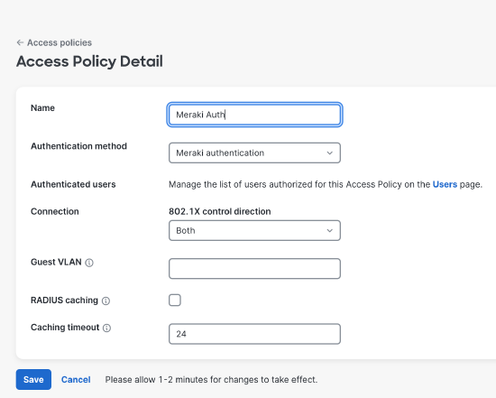

Creating an Access Policy Using Meraki Authentication
  1. On the dashboard navigate to Switching > Configure > Access policies.
  2. Click on the link Add an access policy in the main window then click the link to Add a server.
  3. Under Authentication method select Meraki Authentication.
  4. Select a Guest VLAN and whether to allow System Manager enrollment.
  5. Click Save changes.
This is an image that demonstrates Creating an Access Policy Using Meraki Authentication.
