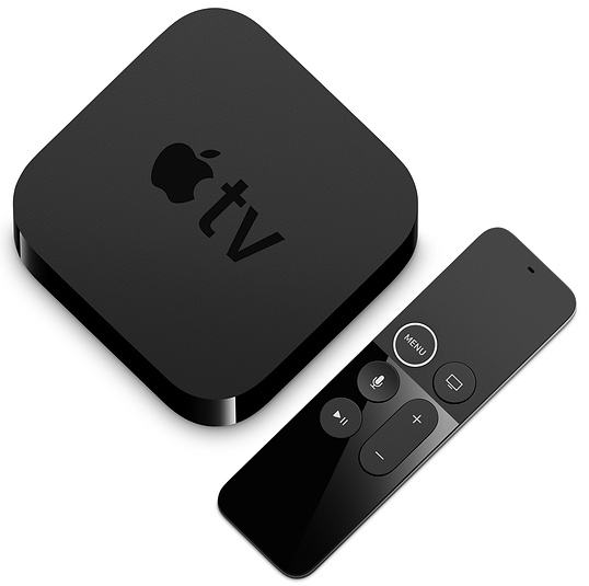

tvOS devices in ADE can use an automatic advanced setup feature which allows seemless flow into the homescreen from an out of box or factory erased device. With the ADE setting auto-advance Setup the tvOS device(s) will go through the entire Apple tvOS Setup Assistant automatically, so you do not even need to choose a language or pair a tvOS remote!
To enable Auto Advanced Setup Enrollment for tvOS:
- Assign ADE settings to the tvOS device(s) and enable the Auto-advance Setup option.
- Plug the tvOS device into wired internet connection. WiFi is not recommend for this automatic setup.
- At the first Apple Setup Assistant screen "Pair Remote" do not pair the remote. Wait 30 seconds or so, and then the tvOS device with automatically step through the entire Setup Assistant and reach the homescreen!
