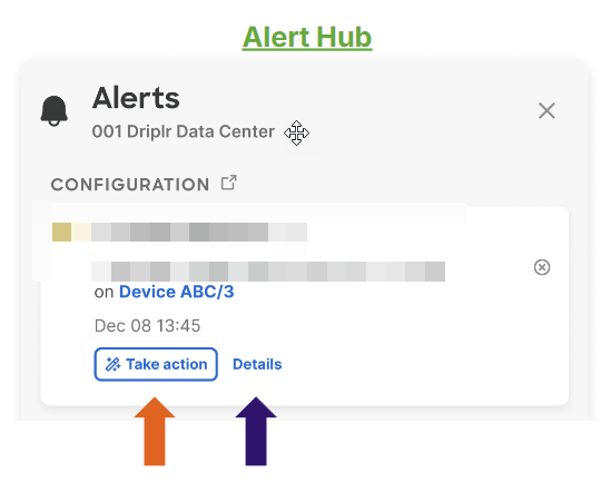

You can start the RCA process from three entry points: the Alert Hub, Device Details Page, and Organization Alerts Page. Use either the Alert Details or Take Action Link/button to open the RCA side drawer workflow. These examples show where you can begin RCA troubleshooting in the Dashboard.
  The image is displayed to illustrate the three entry points—Alert Hub, Device Details Page, and Organization Alerts Page—where users can begin the Root Cause Analysis (RCA) troubleshooting workflow in the Dashboard, with Alert Details and Take Action links/buttons leading into the RCA side drawer workflow. This demonstrates the generic locations within the Dashboard to start the RCA process.

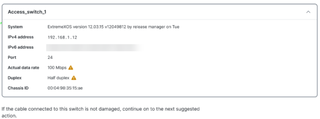

1. Cable Test: This tests the cable and the switch port connection used by the AP. The test identifies the uplink switch and prompts you to check for cable damage.
he image is displayed to show that the cable test checks the cable and the switch port connection where the access point (AP) is connected, identifies the uplink switch, and prompts the user to verify if the cable is damaged or not.

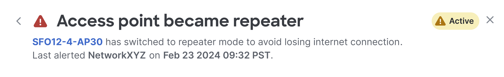

Access Point Became Repeater
Alert Description
This alert is generated when an AP is suspected to have transitioned to repeater mode unexpectedly, allowing network administrators to easily identify and correct the issue. The following conditions have to be met for the alert to be triggered;
  • The AP has been claimed and added to a dashboard network
  • The AP is currently operating as a repeater mode AP
  • The physical Ethernet link on the AP is up and operational (PoE + Data)
  • The AP does not have a Preferred mesh gateway configured on dashboard
  • The AP was operating as a gateway AP at some point during the last three weeks
This image is displayed to inform users about an alert that an access point has unexpectedly transitioned to repeater mode, detailing the conditions that triggered the alert.
Guided Troubleshooting Flow
Suggested actions for AP became a repeater
  • Set the preferred gateway, if the AP is intended to be deployed as a be a repeater
  • Compare VLAN settings between the two AP PoE ports to resolve configuration issues. Ensure each VLAN provides a valid IP and gateway for the AP and can reach the cloud.
  • Run a cable test (TDR) from the switch if supported to confirm all pairs are intact and correctly placed. If the switch does not support this, physically check the cables, patch panel, and connectors for a healthy connection.Perform a cable test (TDR) from your switch, if capable, to determine if all pairs are intact and in the correct placements else physically validate if the connection (Cables/patch panel/connectors) healthy.
  • Perform a wired packet capture of the switch port the AP is connected to, checking to see the AP is able to obtain an IP address (DHCP), is able to reach its configured gateway, and is attempting to reach the cloud via its Ethernet uplink.

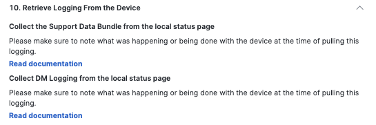

    10. Retrieve Logging From the Device
