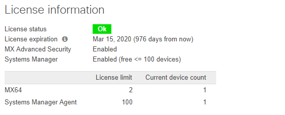

Co-Termination
The Cisco Meraki Co-Termination licensing model works on the basis of co-termination, which means that for any given organization, regardless of how many licenses were applied or when they were applied, the license expiration date for all licenses claimed to that organization will be exactly the same. This is accomplished by averaging all active licenses together and dividing by the license limit count of devices in the organization.
For example, if an organization had two separate Enterprise AP licenses, one license for 2x APs spanning one year (365 days) and another for 1x AP spanning five years (1,825 days). The co-termination value would be calculated as ((1825*1)+(365*2))/3= 851 days total for all three APs. So assuming all three licenses were applied on the same day, the organization would have a co-term date of 851 days from the start date of the licenses.
If the licenses were not applied at the same time, for example if the five-year license was applied halfway through the one-year license, the co-term calculation will take that into effect. In this case, the calculation would be ((1825*1)+(182*2))/3=730 days total for all three APs.
The organization co-termination date does not depend on the current device count, but rather the license limit. Removing devices from a network or organization will not impact the co-termination date.

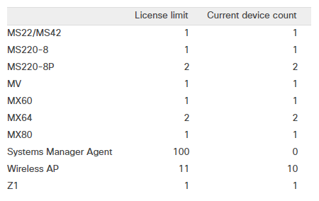

Cisco Meraki licensing is applied on an organization-wide basis. This means that a license isn't purchased for a specific serial number or device, rather each license added to the organization increases the number of a specific device type (the license limit) that can be added to networks within the organization.

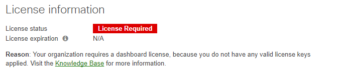

The 30-Day Grace Period
The number of devices in an organization can not exceed the license limits. If this occurs, the organization will enter a 30-day grace period, during which the organization must be brought back into compliance, otherwise it will be shut down until proper licensing is applied to the organization.
During the grace period, network clients will not see a difference.
Should an organization enter the 30-day grace period because of exceeding device license limits, it can be brought back into compliance either by removing devices from networks within the organization or through purchasing additional licensing. The only other time an organization will enter this 30-day grace period would be if its licensing has expired by passing the co-term date. If this occurs, the only way to bring it back into licensing compliance is through the purchase of all new licensing for active devices.
For example, if an AP is added to an organization that already has five APs and licensing for ten APs, no additional licensing is required because the organization's license limit is higher than the number of APs in the organization. But if an MX series security appliance was added to the same organization, it would enter the 30-day grace period because the organization is not licensed for MX security appliances. For more information about the 30-day grace period, read the License Limit and Current Device Count section of this article or refer to the License Info article.

From the Organization > Configure > License Info page, the Add licenses link allows organization administrators to add additional licenses to their organization. This can be done to either increase the total number of devices licensed to the organization or to renew the existing licensing for all devices in the organization. Adding additional licensing to an organization is a simple five-step process, outlined below.
- Click Add licenses and Enter the 12-digit license key you would like to claim as shown in the gif above.
- You will see a modal that will allow you to select either To add devices or To renew current licenses.
- Click To add devices.
- Review the changes on the License Info Preview Page.
- Fill in the box next to Enter the new license expiration to confirm this addition with the expiration date seen above (otherwise the Add license button will be greyed out).
- Click Add license again to finish claiming the license.
Claiming a new license with the claim type of License more devices will simply add the new license count to the existing license limit of the organization and alter the co-term date appropriately.
- Claiming a new license with the claim type of Renew my Dashboard license will invalidate any previous license limit counts and force the organization license limit to match only licenses applied during or after the most recent renewal action, in addition to altering the co-term date for the organization.
