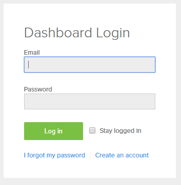

  1. Create the organization at dashboard.meraki.com if it has not been created.
The image is displayed to indicate that the organization must be created at dashboard.meraki.com if it does not already exist.
